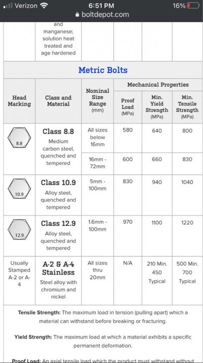

Ok so this is a shot in the dark but here we go.... I found this bolt under my spare tire today and I have been searching frantically to try and find where it came from as it looks pretty substantial. I can’t seem to find where it came from. Truck info:
2016 Ram 2500 SLT 8ft bed. I have never seen this bolt and it wasn’t on the ground before today. The size bolt is a 3/4in 2.5in long and on top it looks like either 109 or 10.9 with a wave mark under it.

Whatever it is, its metric if the marking is 10.9 and it is NOT a very strong bolt.......so in that case .......look at your exhaust manifold bolts[emoji23][emoji23]
