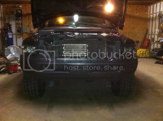

Been leaking transmission fluid for a while and its everywhere on the front suspension. Well I finally found there's a transcooler sandwiched between the radiator and condenser. Well its pouring out trans fluid and a new OEM one is a 300-400 bucks... WHEN IT RAINS, IT FREAKING POURS!!!

Just buy an aftermarket cooler and install. They're more effective and less likely to clog or leak.

I was thinking about that, they're 60 bucks at Oreilly's. Just trying to think of a place to install it.

On the front of the condenser like mine

Let's see here...These are "in production" shots
