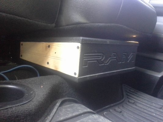

I have a single ported 10'' Fox box... I had to plug the port hole because I was getting very muddy, long bass notes and the port noise was driving me insane. Now that the port is plugged my bass sounds much tighter and more precise.

How did you plug it? I was thinking about trying on mine but worried about rattles coming from it, leaking or screwing up the box

I stuffed the hole with a grout sponge first. It was about 2'' thick and conformed to the size of the hole really good. Then I cut a piece of 3/8'' Lauan that fit all the way down the length of the box. I Siliconed around where the Lauan met the Fox box just to seal it off better. Then I used short sheet rock screws to screw the new board down.
I used a sponge inside the port hole because I was worried about all that pressure blowing through the Lauan. In my head, the sponge acts as a kind of barrier between the sound waves and the thin plywood covering the hole.
I still may paint the Lauan with bedliner just to match the Fox Box.
Notice in the last picture how I raised my seat up a bit with a couple of the kids' Legos... Worked perfectly!

Ah. It probably didn't sound very good because the air space requirement for that sub is a lot more than the volume of the enclosure. You were choking it to death. And getting tons of port noise from running stuff below the 36 hz tuning frequency. Sealed up, it should be about right. Glad you got it sounding decent. I don't have any issues with my RE Audio sub, but I also don't play low stuff. Rock and metal only hit my sub. With the occasional old school rap, but none of that new garbage. ;)
