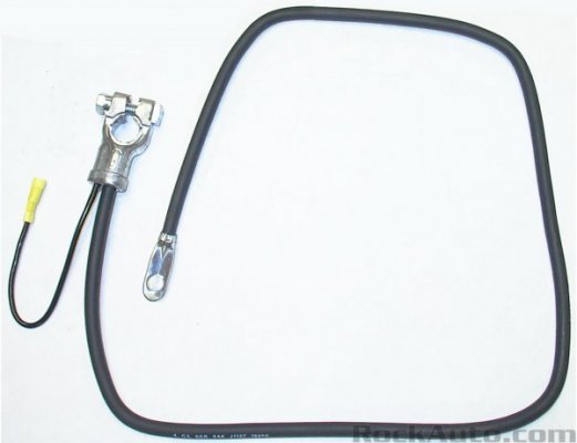

try what i told you. to me it really sounds like a bad connection on the main power wire between the battery and power distribution center especially since stuff in the cab stops working also. i know i have dealt with more than my fair share of bad battery connections which is why when i buy batteries i switch to side post terminals. most aftermarket battery terminal clamps especially the painted ones like you have are junk. i would maybe even check the store to see the price on a new main power cable/clamp setup is. i know they are usually about $10 for a pretty long one but you might be able to get a 2ft one or something like that cheaper since i doubt you really need one that is super long.

What type of clamp would you suggest? Going to check it out after work tomorrow.

either a crimp or solder on battery terminal would be the best route but might almost need a shop to do either. i really found the coated clamps like you have the absolute worst connection ever even tho they look nice. even just a plain non coated ones seemed to work more reliably than the coated ones but i find they have issues eventually. if you only have 1 wire from the battery to power distribution center than i would look just getting a new molded battery terminal/cable.
