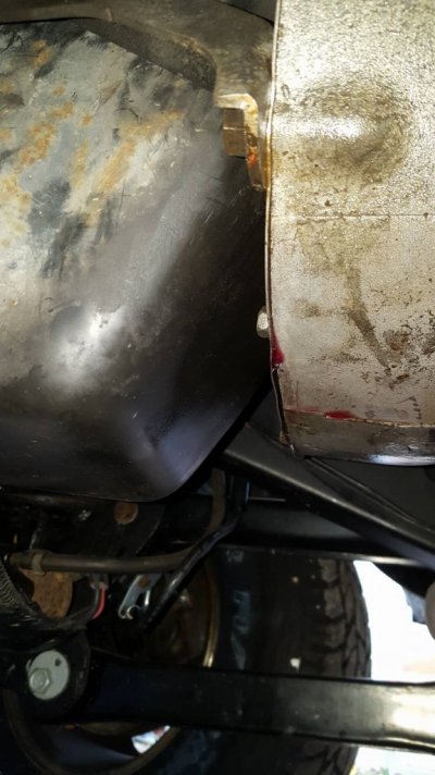

Well, now I have a trans leak. Torque converter?2645b18898a7fc8ae27e92ceef976079.jpg68d11596af556c113849e7a95f64dd10.jpg

Did you separate the trans from the motor when transferring to the newer frame? If so I would assume input shaft seal from being disturbed during the separation and reinstall.
Yes I did. Well guess I need to add that to the list of things to fix.

Not for certain that it is that. Just something else to keep in mind. I got lucky when I did the clutch in my car because it was a common fail point on that make of vehicle
Not sure what else would be leaking but now I get to drop the trans to find out.

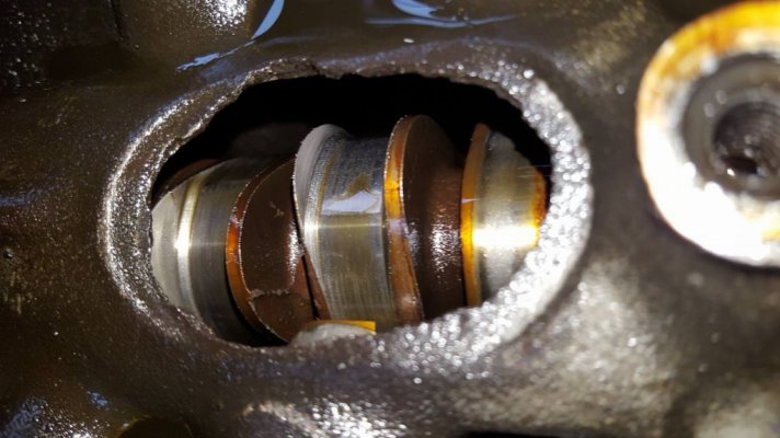

Well found the problem, now I just hope that it didn't damage anything else and that it's all in the pan. New lifters showed up from summit so I am going to replace all of them just in case any others are about to gocc14ee5129740d99897867d5a3b3f3e1.jpga3dcc7edfffa6b4bfe387c932ccd2618.jpg4e720aced4361f4c547fcc5aa433e91b.jpg

Well then. That’ll do it...

have you checked the cam to see if it is damaged? i wouldn't be surprised if something like that could have wiped out a cam lobe
I'm going to rotate it again but I couldn't see anything when I looked

Ok well crap, didn't look at the whole thing when I first took a look. But somehow a lobe for cylinder 1 and 2 are done for. Not sure how I managed to do this but looks like I'll be getting that cam I was thinking abouteba67df795cfb61c4153f42a4aa64343.jpg

well considering how damaged the lifter wheel looked that is not surprising. the wear on the wheel that shows it has been chewing on metal. i personally don't know if i would consider just tossing a brand new cam and lifters in that engine without completely tearing it apart and making sure the engine is clean. if you wiped out 2 or more lobes like that then there is likely lots of tiny metal particles floating around the engine/oil that might have been pumped through the engine while you were driving it.
