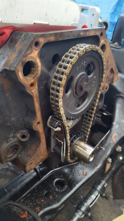

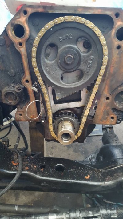

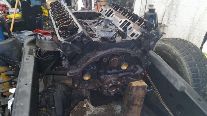

Got my gaskets and various other parts today. Installed the timing chain tensioner and new timing chain from Hughes. Front and rear crank seals installed, oil pan reinstalled.
Working on the freeze plugs. The front 2 had almost no corrosion. 1a003997668d82740b064000b5b159c3.jpgfc91df65415c45d2e577a5c6bf495505.jpg

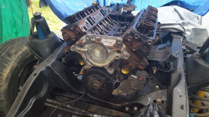

Freeze plugs are in, heads are back on. Next step is putting the trans back in.64385662f579630eee86e7fe87c8322e.jpg52b8ef971d160577896376fad6346824.jpgf669374f177710009cf4d98bacfffb09.jpg0d720d05529cd594134c58c89d72b5e0.jpg4d8f7070a582f19261f556ce540302ca.jpg

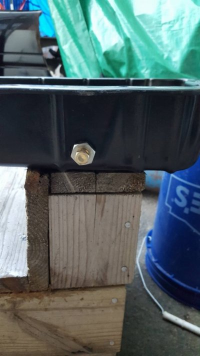

Trans pan now has a drain plug and the upgraded governor solenoid. Added fluids to what I could. No leaks so far. Should be able to get the cab on later this week.7939074709838c6fbbfae4f3efd063b0.jpg7d07913c2fd7b6254a12fd74be4700ae.jpg77b3aea18dae09ee65f4bd89c2c850b4.jpg

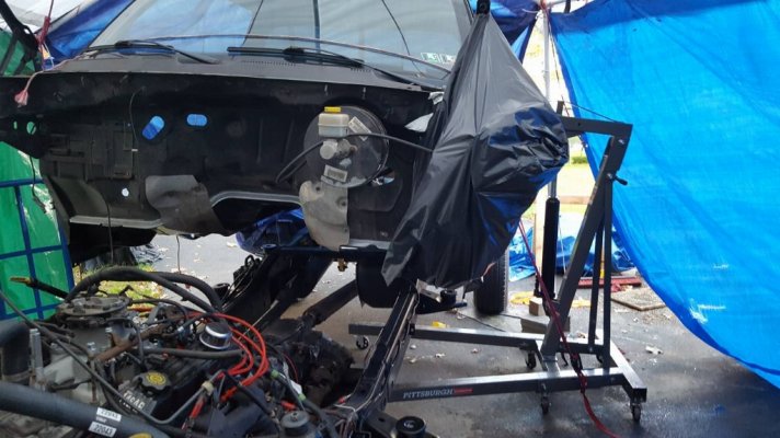

Cab is on. Now I just need to connect everything, haha.99123c72d783faa311ba13fc7398dfde.jpgc9cd104af03592ccf49d0adb76241a52.jpgd9073b65ad6a74449f664b4d539d7be1.jpg

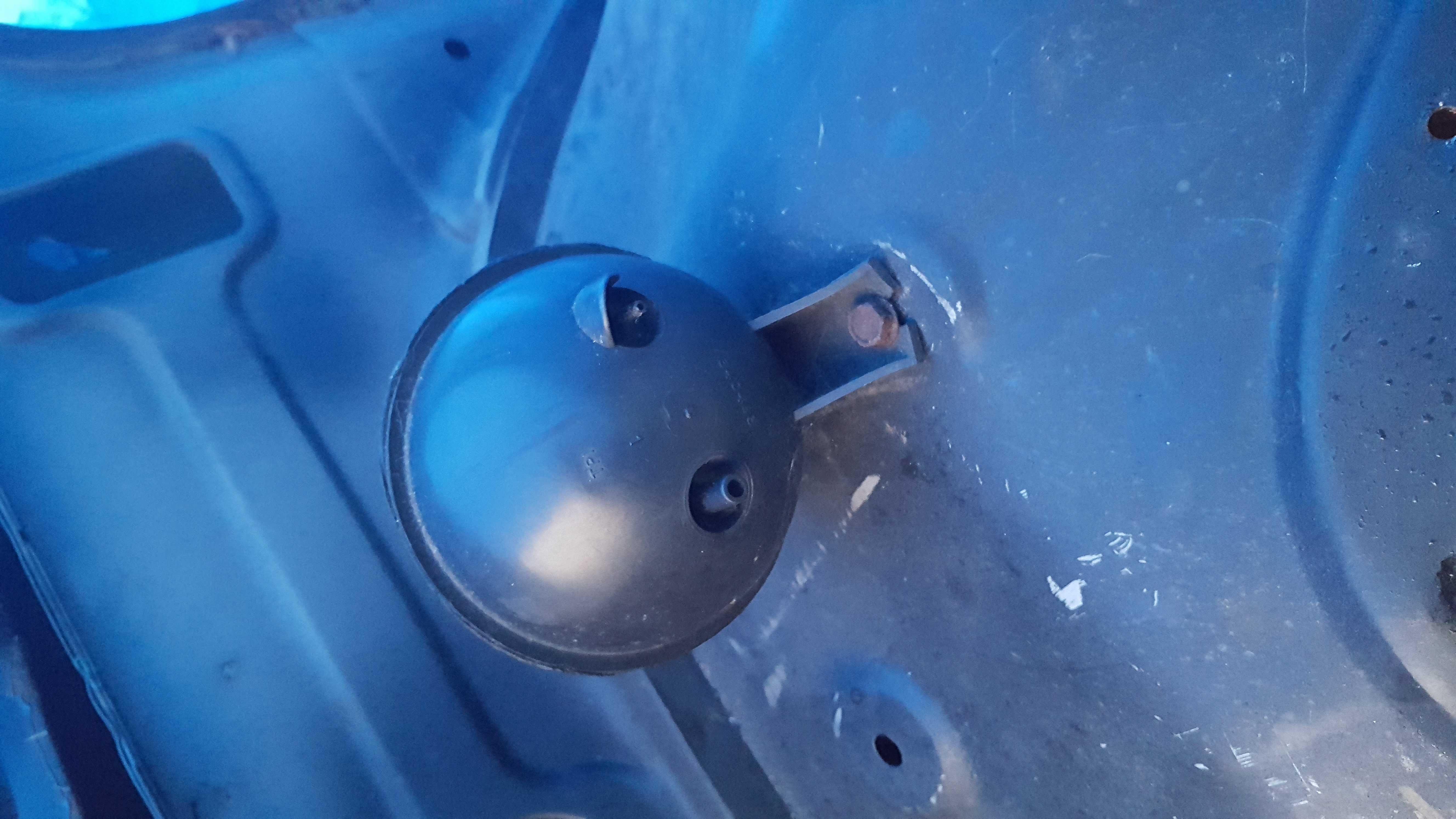

Hopefully someone can help. What is this? It had the vacuum line for the climate control going to it. Is it factory or something somebody added?

Got my answer

From dodge dude94: Those are aftermarket. Supposed to help control the wild vent issue these trucks have, losing vacuum to the mode doors in the HVAC under heavy throttle.

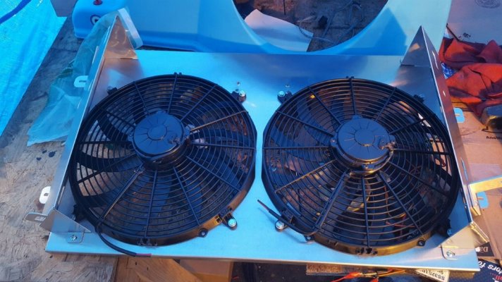

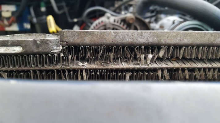

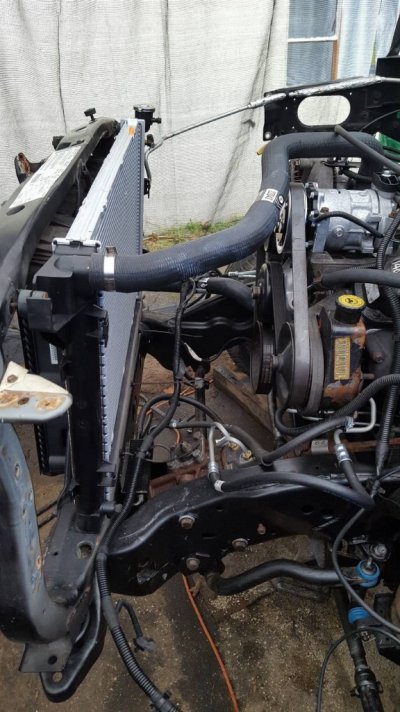

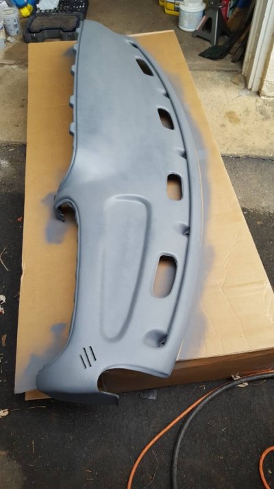

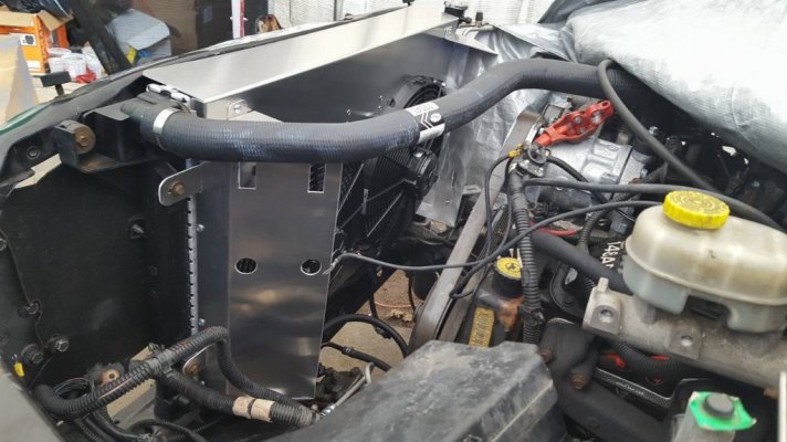

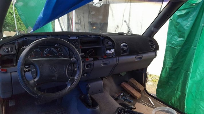

It was a productive weekend. Got my dash cover, driver's seat cushion, and seat cover from Geno's.
The radiator was falling apart so I decided to replace it. Just need to repair the door bottoms this week.4947da4f33e52a048199d62e8dc9aa75.jpg2a869b75393eb068b6dbd991d9564a42.jpg24a0cd141c16ca64c98a8af1e9046474.jpg6b027bbf3cb45919d6a43934bd0ce4ce.jpg088b713d1f688efc4bde510f1ab3c68f.jpg88e17f60a36785f5a81e4d88547a6f63.jpgbfd108997bc592f0f280b8276bbebf69.jpg485342b1cce657ed0f8519876e65bccd.jpg

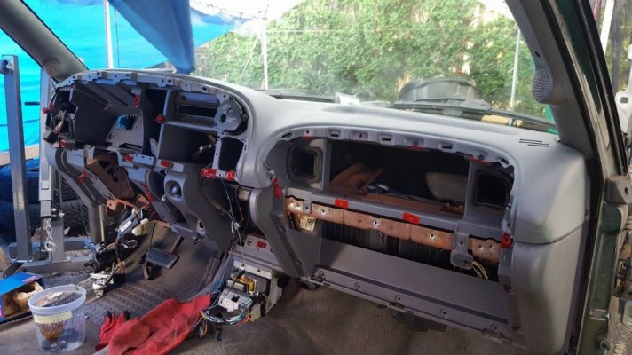

Well crap! This is all that's left in the "seats, trim, and carpet" bucket and I have no idea where they go. Especially that ground strap. 69cf23710ae67c3bd13c28784b7c966b.jpg

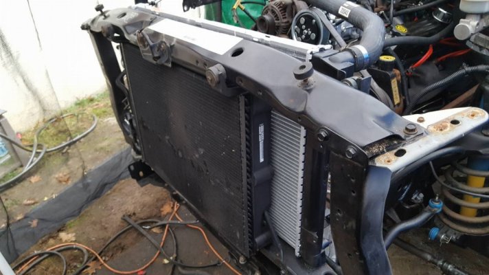

Doors are patched and back on. Got the fans mounted, just need to run the wires. fe8e8ecbc090e0059bdcba7ba6e57743.jpgdc6543fb1a030afcba858b0a1a83065c.jpg58ad93ccb4d674b0d9401c34fed6e3ad.jpgf76e6272e95022a52f55a294b883a3de.jpg
