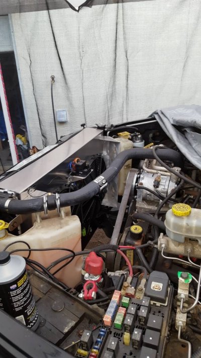

Finished hooking up everything in the engine bay, bled to brakes, checked fluid levels and installed a new battery since the old one was 8 years old.
Fired it up and let it run for a little bit. Still have some stuff in the cab to do but it runs!32ca9197c7d27272adb2dfa81ccc27d8.jpg587b99def17f6eed8e846dd733921c68.jpg

Nice I bet your pleased all that hard work finally going to be able to call it done

It's almost done just wish I didn't have to work so I could finish it sooner.

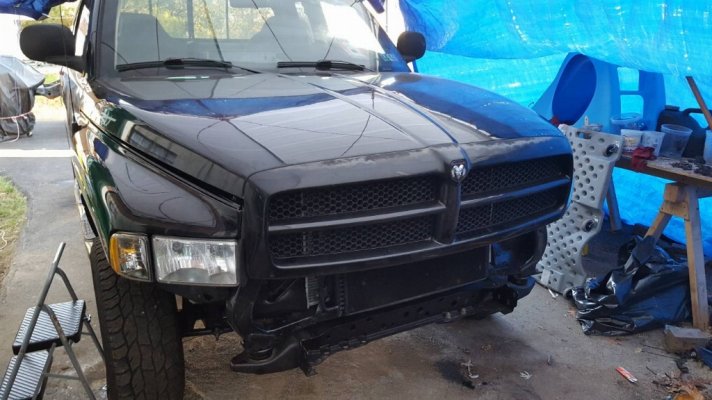

Got the hood on today and beat some dents out of the bed. Was going to turn the truck around so I could put the bed on but the truck refuses to start, just clicks. Going to pull the starter off and check it out but, probably going to have to replace it...wonderful8247e0af7d44fda57d1032041a8458d0.jpg

Hope it’s an easy fix. Has the truck actually turned on recently?

Yeah, it was running earlier. Heated up to operating temp, fans cycled a few times. Sat for maybe an hour? Now it just clicks. Jumper pack needs chargered and I can't find the cord to charger it. Battery voltage is 12.3, maybe not enough juice to crank?

Hmm. It sure exactly what voltage it needs, but that sounds like enough. If not the starter, how about the fuel pump?

Truck won't crank, only get clicking when I turn the key

And now I have nothing. I'm thinking the ignition switch is bad. Dash won't light up now.
Dropped the starter and hooked it up to a jumper pack. Seemed to work fine. Hooked it back up and tried to crank it and now the nothing has power.

are you sure you got a good connection at the battery? the clicking you are hearing is likely the solenoid engaging but if you don't have enough power getting to the starter it could cause it to not want to start. i would possibly even check the ground wire or maybe break out some jumper cables and run them straight from the battery to the starter. should make a difference to it.

I cleaned the connections at the starter and battery. But now I have nothing, going to check fuses in the morning

i would still try running a jumper cable from the battery to the starter. i actually just noticed you have aftermarket battery clamps. i don't know how long you have had them but to me i hate the ones like you have and have had bad luck with them in the past.

The clamps have been on for a few years. Hooked it up on the bench using the positive wire from the starter to the jumper pack and clamped onto the housing. Used the key to crank it and it engaged like it should.

Had Autozone test it while it was out, everything passed. Already swapped relays around with no change. Going to clean up the mounting areas before putting it back in.

Still the same issue. I tried it once and now the dash won't light up again. The parking brake light is the only thing that comes on and it's dim.
When I reconnect the battery I can hear something engage up by the firewall or cowl. Can't really pinpoint it. I'm wondering if something else is drawing power.

you don't necessarily need clean things up. just hook up some jumper cables from the battery to the starter. it will tell you whether you got a bad connection there or not. if that doesn't solve the issue you could also try hooking your jumper pack to the power distribution center and see if it makes a difference to what gets power when you turn the key on. i am still thinking the connector at the battery might be the issue. it sounds like a limited amount power is making it into the cab or to everything.

Thanks for your assistance. I'm not sure why it was acting up but I got it to start.
Pulled the fuse for the ignition wire for the fans, I have it hooked into the cigar lighter since I don't use it and it is only hot when the key is in run.
Started it up then put the fuse back in. Started it once after that with no issue, I will see how it acts in the morning.
