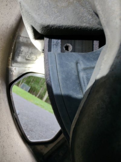

These little strips of very light rust are on each rotor. Very strange that it's consistent on both sides. Won't get to pull them until this weekend but it really look superficial. Could buff them out but will likely need new pads. And need to figure out what caused it. Good times.

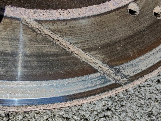

The outside edges are normal. The band about 1/8" in from the outer edge is what they are claiming is corrosion and failed me for.
Yes, that's what caught my attention. Post some pictures of the pads and rotor when you tear it apart. It looks like something is smeared in that band not corrosion. Maybe it's a improperly seated pad rivet that is just starting to score the rotor.

Looking at the pictures seems you have a hole in a non- drilled rotor what is that about?
And yes the outer ridge of the rotor looks like that but the inch and a quarter gap on the surface of your rotor, does look like its not making contact,
42K is time for inspection don’t you think ?

That does not look normal. It appears the pad is making contact with the inside 3/4 of the rotor and then it misses about 1/4" and then makes contact on the outside edge with the small normal ridge on the very outside edge. Perhaps where a rivet may be if the pad was worn down enough? Good catch on the part of the tech.

So, got it pulled apart today. These were drilled and slotted rotors. I knew I needed to replace them anyway and ordered the new parts this week. Turns out it was a build up of brake dust in one of the slots that then glazed over and created a very slight issue on the pad. I still contend it should not be enough to fail inspection.
Looks like I'll need to periodically clean out the "slots". Hadn't remembered that they are not real slots through the rotor but just long dimples. Going to clean out the reara tomorrow just to avoid fail later.
