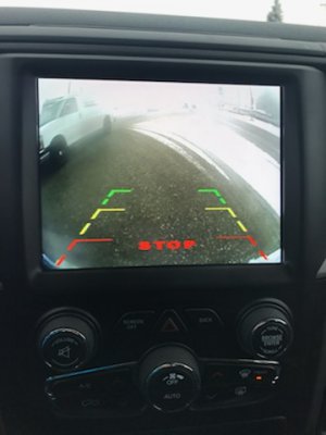

I reviewed a lot of cameras for features and quality. In the end I chose the Coolint CT-106S camera from Amazon. I'm satisfied with the image quality. It's not 4k lol but given the price point, it meets expectations in day and nighttime conditions. This camera was also positively reviewed on Amazon. The main features are that it is super easy to aim (ball socket. Up/down/left/right/rotate). Tighting the outer ring secures the camera in place. It can be used with or without parking grid (disabling is permanent) and the image can be flipped from reverse cam to front cam (another permanent change). Several cameras I reviewed did not indicate front/back orientation or the ability to change it.

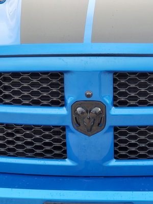

The first step of the install was the scariest. Since the emblem cam did not meet my requirements, I had to drill a hole in my fender. Yes, on my brand new truck. (I had considered a license plate mount but decided I wasnt happy with the appearance). Don't worry, the story has a happy ending.

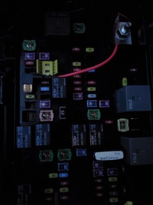

For power, I tapped into fuse 101 using a micro2 fuse tap. This is the only spot in my fuse box that is live but doesnt have a fuse in it. I was led in this direction from another thread. Testing indicated the circuit only had power when the acc power was on so it was an appropriate choice. I ran the power cable out through a gap in the fuse box. I grounded in a location just to the right of the fuse box.

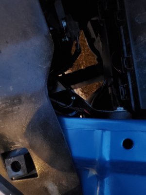

I connected the RCA extension cable (ignore the red cable at either end) and passed it through the firewall by drilling a hole through the clutch plate. (Plate removed by releasing two bolts inside the cabin)

From there it was just a matter of fishing the RCA cable, removing the stereo, setting the jumpers on customtronix enzo and connecting everything. After that I reset the stereo 3 times as directed and tested. Testing was sucessful and I put everything back together.
Now when I go to park this massive beautiful beast, I dont have to worry that I'll hit something I cant see.
