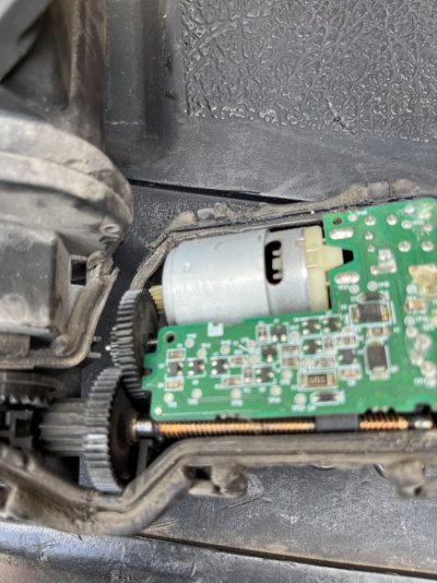

Pictures as promised. Surprised at the plastic gears and brushed motor.

It was an easy fix. Got the OEM part for $400 and it took 10 minutes (4 10mm bolts and a connector).

oe part is only 125 at cm gearworks. did you take apart the piece that has the fork ? wondering if theres a spring on both sides. is that a hole at the red arrow ?
