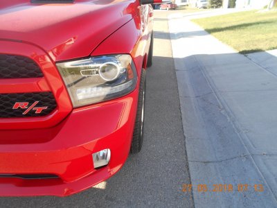

They move the wheels out roughly 3/8" on each side. I'm running narrowed drop spindles on my 4X4.They've been narrowed 5/8". My buddy owns a machine shop,so he narrowed the spindles and caliper brackets for me for a decent price.The 4X4's run just under a 1/4" (0.20" ) wider front track then the 4X2's do.
295/45/20's on the front, 305/50/20's on the rear,on the stock 20X9" sport rims
