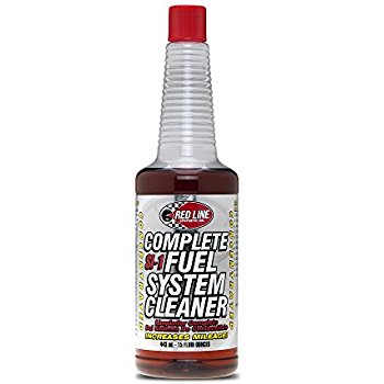

I use Redline fuel treatment.

Redline S1 or Amsoil PI, both engineered to clean with PEA (polyether amine) and be an upper cylinder lube. Most other PEA cleaners have a fraction what these two have. Always check the msds, PEA % should be noted. Most other cleaners are solvent based not detergent like PEA. Explain how adding a solvent to a solvent will clean better? Sea Foam is great if used in crank case or vacuum straight into combustion chamber. Upper cylinder lubes are great, but you probably don't want to use them on their own long term, maybe run a little techron every couple months if you just use lucas.

How often and how much of the S1 is to be used? I know the Amsoil is only supposed to be used every 4000 miles. That's one of the reasons I use the Lucas treatment is because any over treatment will not hurt. I'm more concerned about it cleaning away something that shouldn't be cleaned away.

I get Costco gas, so I use it every tank 1/2 bottle s1. I always get it less then 10 bucks shipped free from ebay if you buy 6., Amazon cheaper if you buy a case. With new ethanol mandates, great to have the upper cylinder lube and cleaner all-in-one.

2. Redline S1- 25-35%

Redline 15 ounces - less then $10 shipping free
