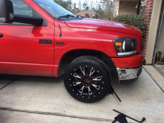

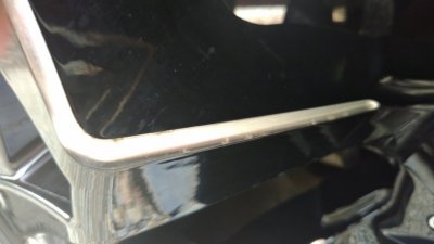

bought a set of gloss black Fuel Assault wheels in September of last year. It's been just about 6 months since they've been on the truck and they're already pitting all over the silver machined edges. Needless to say, I'm not too happy with Fuel wheels and I'm sure this will be my last set. Some of the black areas on the wheels already have stains or water marks below the surface that doesn't come off with washing.
I'm in NJ where we see snow and salted roads in the winter, but I'm diligent about getting to a power washer after each storm so the salt never sits on the wheels or my truck for too long.
I took pics of the wheels and sent them to the place I purchased them from and this is the response they sent today:
Corrosion on the milled edges is not covered under warranty, but can be removed with careful polishing with an aluminum polish. We use Eagle One Nevr-dul.
Thanks,
Wheelsforless Tech Department
254-728-3624

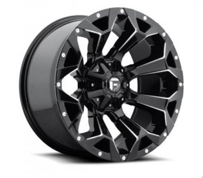

Anyone else experience this with their Fuel wheels? I attached some pics of mine. I also attached a stock pic of the wheels for those that aren't familiar with them.

I would appeal directly to the manufacturer. The retailer is off base in my opinion. The "milled edges" that they reference don't actually appear to be milled. And, they appear to have a clear coat finish, negating any b.s. about milling (i.e. the "milled edges" are finished, not raw milling). I would ask the dealer to advocate for you with the manufacturer.

ive had my fuel wheels for about 3 months now, my neighbor has the same exact wheel on his truck and its been over a year, the only thing i noticed about them is the machined area is raw aluminum, no coating on it, which even leaving crud on it for a day can start the surface breakdown, I honestly believe its part of having these kind of wheels, ive seen american forces less than a year old that are absolutely ruined, that being said, the right polishing application will bring them back to what they should be, to compare them to OEM wheels isnt a fair comparison, OEM wheels are either a clear coated painted surface (black or silver) or chrome, and just like your car the painted surface will hold up stronger than non-coated aluminum, id go as far as saying the black is not clear coated either, mine had a matte black finish that i polished to a gloss, which the black on mine actually will stain if i let them air dry after a wash...
im not defending Fuel in their lack of willingness to help, but IMO this lack of them holding up seems to be the norm for alot of the bigger name brand wheels, that is unless you can 100% verify that they are truly powder-coated and sealed.
After seeing how bad all these big named "off-road" wheels hold up to normal wear and tear, i actually clean and wax my wheels weekly, and thats also why i didnt buy into the big Billet fad on my lowered truck
again im not saying anything against the OP or anyone who has had these problems out of their fuels, but in my body shop i see a ton of these high dollar "forged" wheels coming in pitted up or just terrible looking and its almost always caused by the wheels not having a TRUE protective coating on them from the factory.
also im down here in texas, we dont salt our roads at all, and the wheels pit up down here, i can only imagine what the wheels look like up there where they salt the roads.
