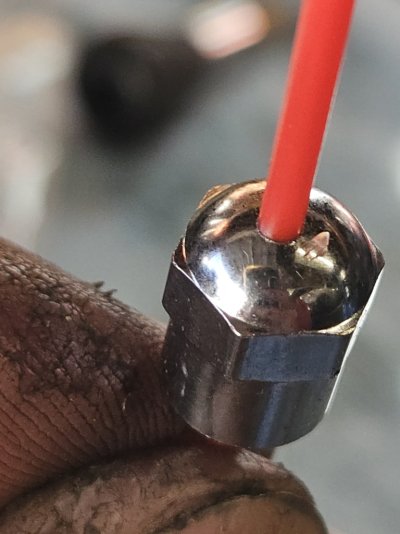

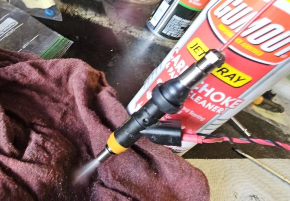

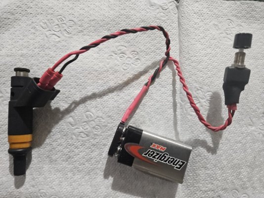

I rigged up a momentary switch with a 9V battery, and a metal valve stem from O'Reilly's. (Thanks, Rick, aka @Wild one)
You can flush them both directions with carb and choke cleaner.

Ed's set up is way fancier then my old set-up,if you're going to build this style cleaner set up,definitely copy Eds set-up :waytogo:
Thanks, Rick.
If I had to do it over, I'd probably lengthen the wiring a bit, its a little tricky to hold the stem/injector, the tube to can, and press the button and spray.
But it worked well enough for now, and got me through the job.

Thanks, Rick.
If i'm by myself doing them Ed,i'll usually wrap a rag around the injector then clamp it in one of my bench vises,it's a little easier to keep the injector from dislodging out of your hand
That's a good way to roll.
Do you see what I meant when I said I take the long way around the lake? :Big Laugh: :waytogo:

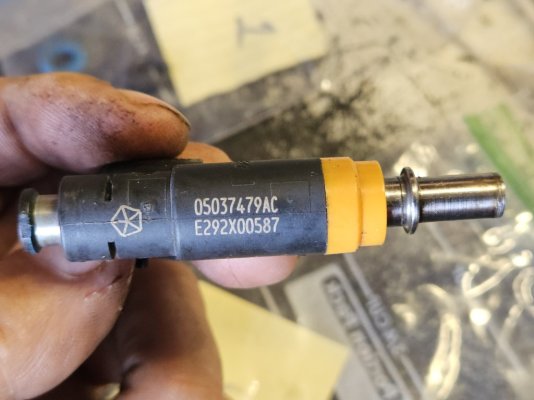

yea i think the most proactive path is just taking care of that one injector. and i been looking like crazy and theres none available.
This is the injector for my '15
Allmoparparts.com shows the same part # for your '09, except -AA suffix. $60 and change. The AC suffix is a later rev, same part.
