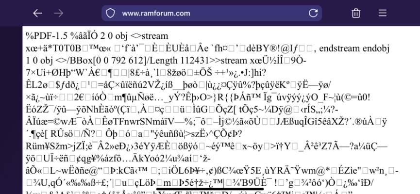

As much I think it is great a few of you post info the format is not relevant for everyone in that type of PDF it may just be for windows or android this is what I see when I open the file.

Ok I figured out I can view the document in iOS by uploading it and saving it to a file
The schematic is the same but I believe the wire colors are only the same for 2016 / 2017
