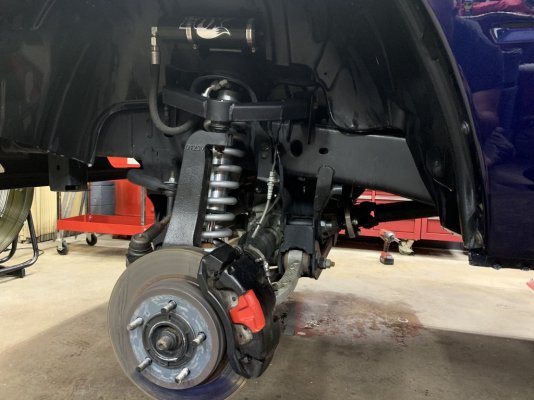

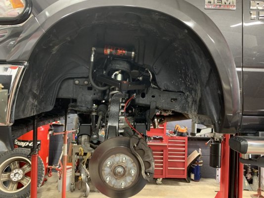

@Paul abel as you can see the size difference these would delete the top hat spacer. @Nick@GotExhaust can get them for you. There are a few other options from procomp and dirt king but the Fox have been the best and still in the same price category

@Nick@GotExhaust may have something but as far as I know the highest is a 6” lifted coil over option that fox offers and I think icon has one as well but not sure how much you can crank them up past 6”
Edit @Quick_Shifter you beat me to it
They can be cranked to 7” safely (I got that info from Fox)

Click on the nick@gotexhaust name above select start a conversation and ask him for a quote.
They are coil overs so they have an adjustable ring to turn. They can be adjusted on the truck to really dial them in to your perfect height
