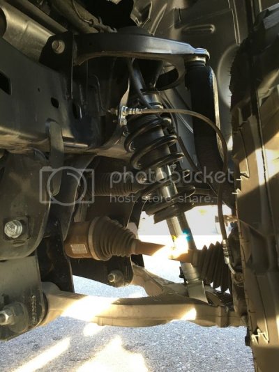

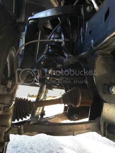

Have you called them or talked to them about it? I would ask them, politely, if they think the CV angle is too extreme. And just see what they say. I would try to stay calm and avoid calling them out or challenging them, at least to start out with. If they tell you to lower it to fix the angles, that's when you :flipthebird:
nickaliRAM
Nov 1, 2012
48
14
Alabama

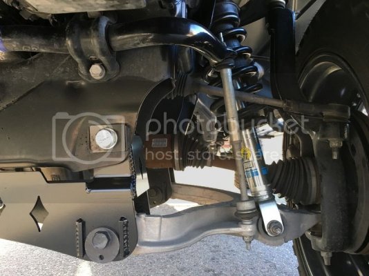

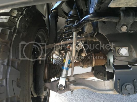

I have contacted them numerous times and they say it is a true size lift. They even compared my fender measurements without a body lift to trucks that have a stretched 6 inch lift and body lift, and I am at the same height as those trucks which I dont really understand if the lift isnt true size, how would it still be as tall as a 6 inch lift stretched with a 3 inch body...
I am 48 inches to the fenders front and rear which is very close to what Sheengon is with his current 8 inch FTS lift and 3 inch body.
Sheengon is 49" Front and 50" Rear, So if I add a 3 inch body, i will be at 51 front and rear and if I go to 40s, that will had about an 1" to 1.5" depending on air in the tire, so I really just dont know. I have had 3 shops look at my angles and they say that is nothing. So I am at a loss.
SilverSurfer15
Feb 27, 2015
400
155
the situation was more about the differential being dropped the full amount, I don't doubt that your truck sits up as high as the others. My question is why wasn't the differential dropped all the way? If you want the truck to sit at X height, why wouldn't you build the kit around FLAT cv/tie road/UCA angles at X height? Why would you any type of preload to achieve the X height? You don't need to.
Your angles arent BAD, they just aren't flat. The angles like WAY better in the recent pictures you posted vs the original ones.
If you look at a FTS 10" it, or a Cognito 10", on a 2500HD gm truck (one that hasn't been cranked up) you will see the cv angle is 100% flat, probably better than factory. Now, sometimes you do have to decrank them a little in the ~9.5" area to get completely flat but the concept remains. I suspect you would need to lower your truck down around ~7.5" to have a completely flat cv. Why wouldn't you just build the kit to have flat angles at 9? Then it would be stretchable to 11-12".
one of two things is happening here:
1) the diff is dropped ~9" inches and your truck is set at ~11" total.
2) the diff is dropped ~7" and your truck is set at ~9" total.
It CANT be dropped 9 inches and set at 9 inches, unless your factory cv angles were the same you have now. Which I highly doubt.
Theres a very easy way to solve this, stick a tape measure on the mounting holes on that front drop bracket. Whatever that number is, that's how far down the diff should be in comparison to the stock location. Roughly anyways. You can get more specific and try to measure where the diff previously mounted vs where it mounts now but it will be a little harder to measure.
