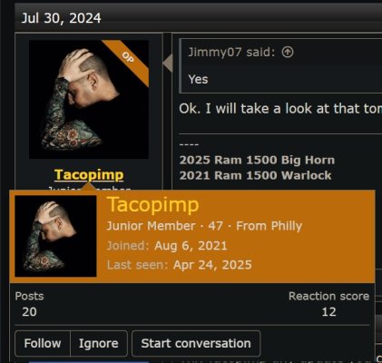

Tacopimp hasn't been here in a while and doesn't seem interested in sharing.

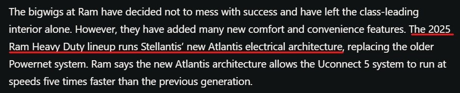

According to this attached Stellantis document, the 2025 HDs also use the Atlantis data architecture.
And, this excerpt I scooped.
I refer you to Jimmy's post #6 above and suggest you try his recommendations.
