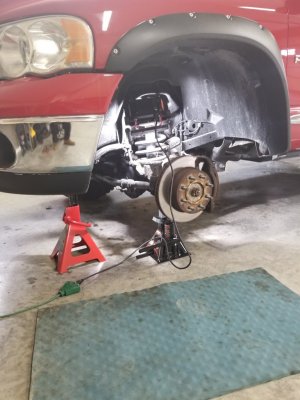

My last garage I used a buddy heater, ok but floor stayed cold.
Current garage I plumbed up " hydronic " hot water lines running to my outdoor stove....floors obviously stay warm.
In garage all winter long, keep it 55*
In it now. LolView attachment 159861
