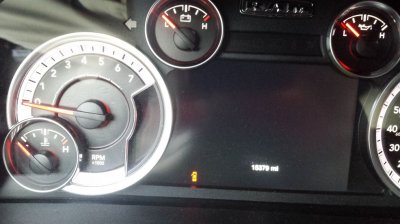

Hey everyone,
I just recently purchased a 2013 Ram 1500 4X4 CC sport with the 6.4 bed. It was previously a Canadian vehicle, and my build sheet said it had a 200 KPH speedo. I guess when it was imported to the U.S. someone swapped either the cluster or the garage faces for a 120 MPH speedo.
My question is does the tachometer look like a normal sport tachometer? It shows that it redlines at 3000 rpm. That doesn't seem right. Also my speedometer is off by 2-3 MPH. The digital one matches the GPS on my phone but you can see the needle is off.
If it isn't the correct gauge faces, does Ram sell those and would anyone know what the part number is?

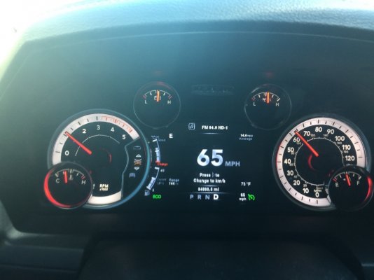

If you have a Hemi that's definitely wrong. I have the same guage cluster and the tach is different.uploadfromtaptalk1442268342862.jpg
That looks like the tach for the Cummins or the EcoD.

The entire cluster can't be out of a Cummins or an EcoDiesel or it would have a DEF gauge. But it definitely shouldn't have that tach in it. Is it actually reading the correct RPM on that tach or is it way off because of the difference in scale?
I am not sure if it is reading correctly or not, but I don't think it is. Can I view the tachometer with the evic? I couldn't figure it out if it is possible. I have 3.55 gears and doing 70 mph it reads about 1200 rpm's so I don't think it is correct.
