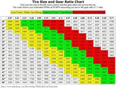

Yes I have a 2015 Ram 1500 Outdoorsman
All the charts i look at say the 3.92 is out of the range for 37's ?

First off, that combo is still in the yellow. BUT, it's obviously not referencing a modern tranny - stating "4th gear at 65 MPH"...!! An 8sp with 3.92 and 37s is very driveable. If you don't have enough power, jump to minimum of 4.56, or go as high as you can if you want the most power. It will be expensive. A supercharger might be a better way to go in that case.
