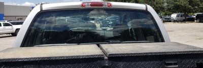

Dont really need to run the vin, was rental truck before my dad got it. has the tow package, came stock with 17's. my farther did find a guy on CL back in the day wanting to get rid of the 20's on his 04 or 05, they swapped and my dad payed him like $100ish. no infinity system, i plan to put something better then stock, kenwood HU/kicker 6x9/6.5 maybe a amp. was watching some videos on sound deadening cars, etc. i'm planning on buying some to do the roof/floor/behind the back seat. Got the truck back today, will take a picture of the engine bay to show off the intake :D
sorry no before picture but i got the new tail lights installed, got them from carid, lumen euro. the shop installed the new headlights for me but i need to get them adjusted, forgot to get a picture of those. they say euro styling for the headlights, i just dont see vs the tail lights. they are blacked out just like the tail lights so no extra chrome. I did get my new 3rd brake light installed but it got dark after i got it installed so no picture. i seem to have so much trouble getting night shots to show off how the look when on. while it looks good on the truck, i had to settle for the 3rd brake light. i couldnt find one to fit with the style of the rest. i also ordered just a dash pad to cover up the cracked plastic one.
i did forget to mention that after the engine swap, i now have a CEL on. has to do something with evap system, some kind of leak at the rear cansitor or the rubber hose. they were not sure which after doing a smoke test. they never told me how much and its was already at $2500 for the engine swap plus a few new parts. since i am having no luck finding this hose/canister for the rear of the truck i think i may have to go to the dealer. im just going to get both to be safe at this point.
all the lights came from carid
Head lights: LUMEN® 87-1001254
tail lights: CG® 03-DR2002TLG2DS
3rd brake light: CG® 11-DR2002LED
