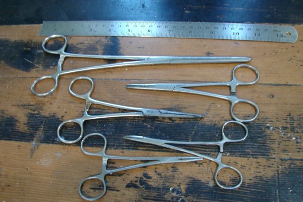

BTW , when you can't reach stuff, this is what I have, the old pair I got when first started in electronics in early 1960, if these don't work, get the hammer out.

04fxdwgi
May 19, 2023
1,803
3,797
Coastal NE North Carolina
2016 1500 Sport
If a key fob was included with the aftermarket remote start, the first place to look would on or around the remote start box that will be zip tied under the dash, likely up by the parking brake area I would think. A installer will stick it where it is easy to get at, but out of sight.
Forgot the coat hanger.

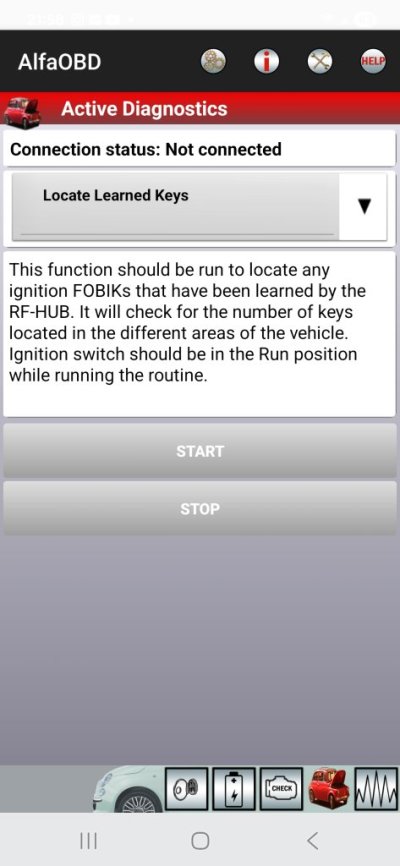

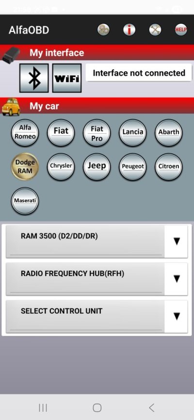

OP, I see you found it. But for next time or anyone else do this.
Use AlphaOBD and under Radio Frequency Hub, select procedure Locate Learned Keys.
The procedure will indicate if there is one near or inside the vehicle and where.
It has a pretty detailed list of locations inside the cab. Try it sometime.
