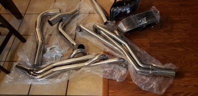

Got the headers today. These are DNA brand sold by protuning lab. The quality looks decent, the welds are good, much better than the price reflects. I've seen BBK headers with worse welds. Hopefully fitment is good as well. I'm debating on wrapping them as well. I also got my $58 CAI the other day. If the stock airbox wasn't falling apart, I'd still use it. Once have have everything under the hood cleaned up, I'll begin the install of these parts.
The master cylinder was leaking, valve covers are leaking, PS is leaking and it's a mess. I hate working in dirty engine bays.
