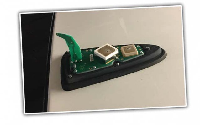

Look at my post #12, just above
It shows the removal of the shark fin antenna
you can plainly see the hole underneath
That hole could easily be closed, or at least modified to get rid of the Fin
