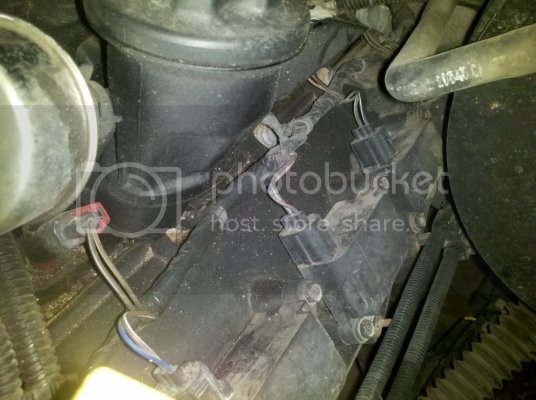

man that show freaks me out lol. what im getting at with the wires question is there are no wires for me to change. i have to change the whole coil pack. didn't know the earlier hemi's were different

wow, i have no idea what i'm runnin apparently. hmm, sounds like a walk out to the garage, and i was gonna go to bed early tonight lol.

you should have wires unless a previous owner upgraded to the 6.1 coil system, bonus...
i found this and its for a 03hemi
bigtigga84
Dec 19, 2010
3,459
35
dela....where?
2006
ok lookin at that diagram................ im not changin those damn things. i hate runnin 8 wires let alone 16
