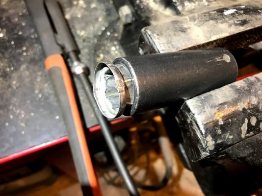

My nut and hat got stuck in the socket so I removed the nut from the hat and ordered McGard. Don't think the hat can just spin free on the nut when they both are hexagon shaped
Nut without "tin" hat

Stefan N, how did you get the "hat" off the nut? Mine just spin but still seem attached somehow.

I don't remember, but the pipe wrench is on the table in the pic and the nut has marks from it, so I'm guessing the pipe wrench

Stick the nut in a vise and use a small chisel to tap the crimp open,the tin covering should pry off then.j

My spinning cap nuts are still firmly on the studs on the wheel. The caps are deformed and rounded looking. Just try to hammer a socket on over it to remove the whole thing? Looks like I might also be able to punch out the front of the cap and rip it off.

Yup, the same thing happened my 09 when I was doing the brakes and said F these nuts. lol
