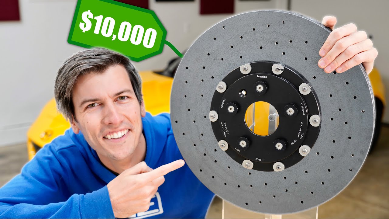

If you want the very best get ceramic rotors.
Do you mean carbon fibre- ceramic rotors?
This article mentions price for a carbon-ceramic brake set-up,and it'll scare you,lol.
Wilwood has carbon-ceramic kits,but you better rob banks for a living to afford them,lol

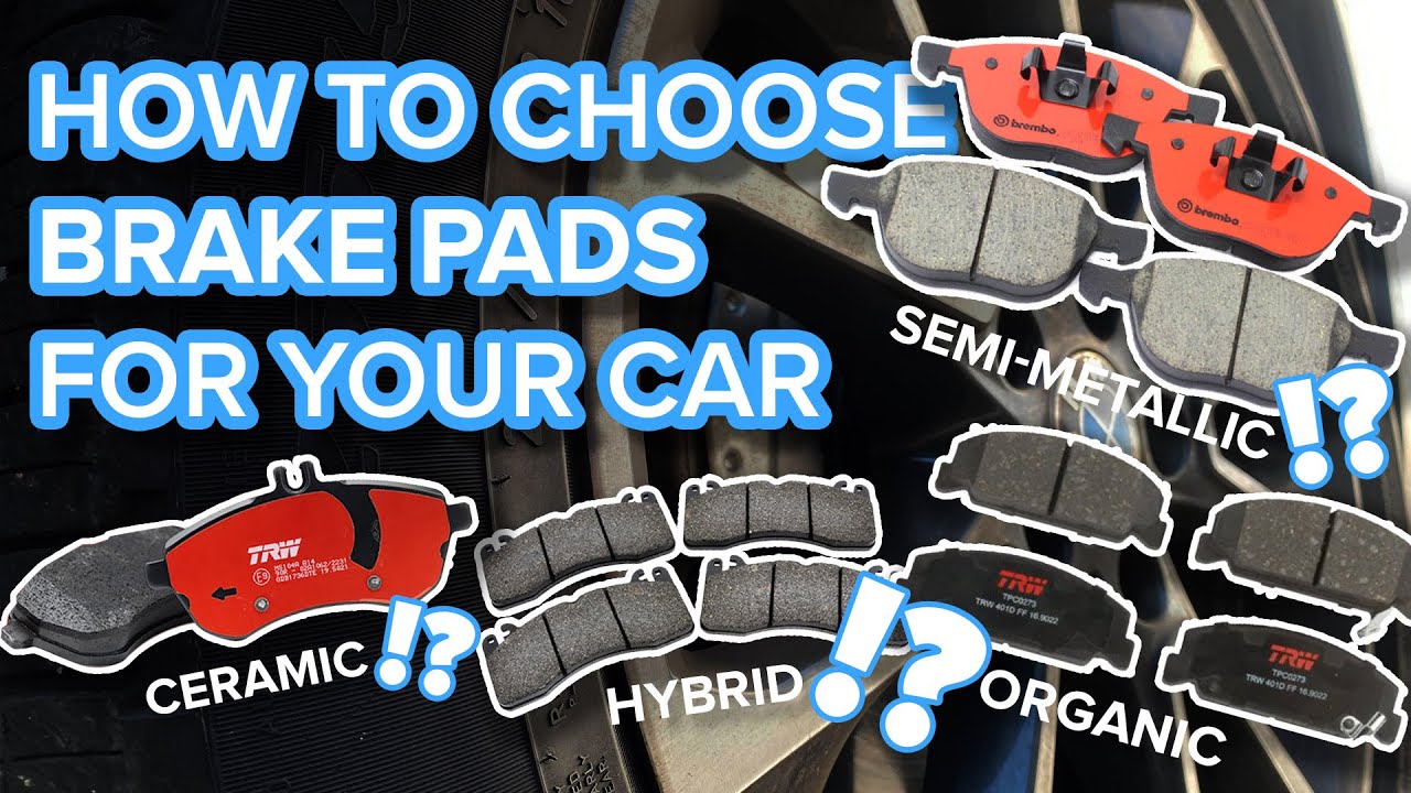

Little more info on pads in this video.
Definitely the best in stopping for sure, but the black dust is unbearable to say the least.
I have ceramic blended pads with Power Stop slotted and dimpled rotors and she stops on a dime.
Carbon fiber blend were better, but the ceramic pads are next best with almost zero dust.
