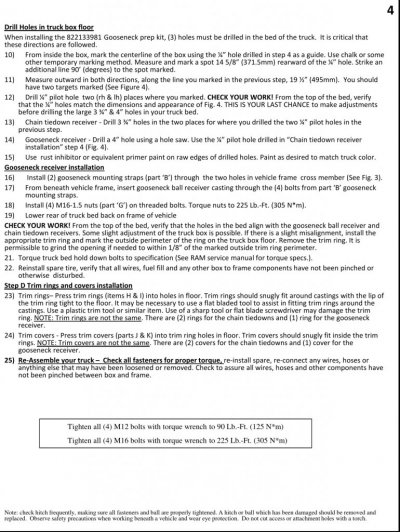

Does anyone have any information about drilling the holes for the factory gooseneck prep kit with ram boxes??? I know the factory kit will will fit with the boxes but I need to know where exactly I need to drill the holes

If I'm not mistaken, when you buy the kit it will come with measurements of where the holes need to be.

It did come with them but they are a little confusing to me

What part in particular is confusing?
I'd first lay out the cross center lines for the ball mount hole.
Then measure back from that center mark to find the cross line for the chain loop holes. Measure left and right of that centerline to find the center mark for those holes of the chain loops.

Update I figured it out and couldn’t be happier with the results
