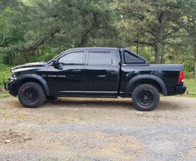

Got a 2012 5.7l 4x4 3.55 gears. 6spd auto Wanting to do a stall and gears
Rammitman
Apr 11, 2016
27
Alabama
I mostly do around town with some highway. Not terribly concerned with mpgs.
I do pull a trailer a couple times a year on a 400 mile round trip, probably around 4-5000lbs.
Tires now are general grabber 33s (never again) too heavy imo. Want to go 35-37 after these.
My question is, I want to go 4.56 gears and a stall converter. I don't know which converter though. Done a little research on here and im seeing mixed reviews. Single plate might be fine but I pull sometimes. But in the next post there's a guy with 700hp running a single.
I don't really care about driveability because I don't drive it that much but I don't want extreme race car either. And it still needs to be able to handle a trailer when I ask it to.
Mods now are:
*superchips dashpaq (barely tell a difference other than transmission shifting)
*Vararam ram air intake (HUGE DIFFERENCE.. everybody needs this)
*3in racelands cut out right behind the rear cat(not sure about performance gains, maybe even hurts a little but damn it sounds good
*synthetic fluids (if you consider this a mod)
Basically what to do I need? Font dif? How hard is it to change a tq yourself? Do I need a custom tune to make it all work?
Ive changed tqs before on old chevys but this is a different animal
