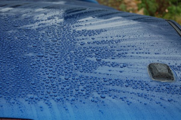

Just found something interesting day one as it is raining today. Next time I will create a thread, but since OP opened door to some discussion I'll post this up. Wow on the difference in the Collinites, I am embarrassed that I didn't test them before. Double coat is a little more work, but worth it. You can see the largest bubbles are the spot in between the coats which is just aio. It is hard to put in word the drastic difference the camera does show it, but man double coat is the way to go if you are just talking about protection. Also, 845 is like one of the smoothest easiest finishes available. As for my other test, CS looks like it is close to failing, but z2/5pro panels has even tighter beads then the double coat. Very happy with double coat, gonna strip the hood and do a test zaino against double coat, two coats of each. I feel that will be the best gauge, but I will leave these other tests to finish out as well. Next time I will start a thread on it. Thanks to pull ya for the info.
First pic- 845-aio (larger bubbles in middle)-marque
Second Pic- Marque-aio (see larger bubbles)-Double Coat

I remember when I was detailing using double coat once, and saying boot that too much work. Why would a detailer go through that when marque is easier and put a nicer look. But now looking at it from a protecton stand point and one guy taking care of his stuff, not detailing many many cars a week, the extra work will gain you more protection, this I am confident after today and seeing what Collinte says in it. Soon, we will see how much more protection happens. Thanks again
