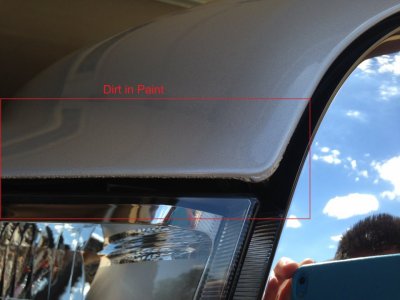

Here are some of the major flaws my truck left the factory with. Also notice in picture 2 the orange peel on the hood which is consistent with almost the entire truck.

Yeah I know now why they were eager to get rid of it. And that's only the major stuff. There is at least a dozen other locations with dirt and drips. The dealer put their sticker over the defect on the tailgate so I didn't even see that one until I took the sticker off. When I took it back to them to show the service manager all this he didn't even seem surprised or anything and just played it down like no big deal.

I actually believe somebody along the line in QC (Chrysler or dealer) actually noticed some of the defects and orange peel because there are a few areas on the truck the paint has been burned thru from using a high speed buffer. But instead of sending it back to be repaired they still put it out there for sale anyway.

Well in my case almost the entire truck would need to be re-sprayed. If It was just the hood, or a door, I would consider taking it in for repair but in no way will a complete repaint be done the right way on a warranty repair. Guaranteed they wont remove any glass and probably just mask into jambs. Dealer was willing to start a claim for me but I'm still convinced the repairs wont be done properly. You are limited to just taking it to a dealer body shop in which I have been burned before on.
