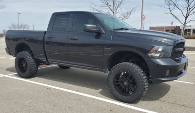

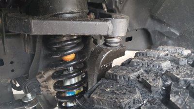

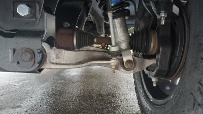

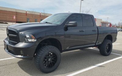

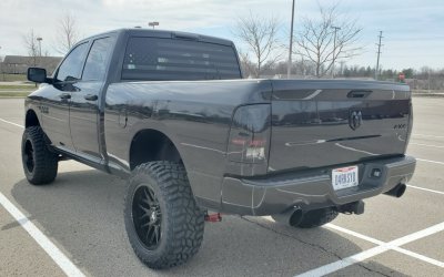

Got my lift on! 4 inch zone and Bilstein 6112s set at 2 inches
FLYxxBOY
Feb 12, 2020
58
75
Ohio
Thanks for everyone that gave me advise and helped me out, especially JB1 and Nick from gotexhaust. As I said it's the Zone 4 inch lift with the 3 inch coil options for the rear plus 1 inch rear spacer. Bilstein 6112s up front set at notch 6 (about 2 inches) with the Zone upper control arms. The CV angles are almost flat and the balljoint angles are great. The wheels are Motiv Magnus 20x10 -25 offset, wrapped in Cooper Discoverer STT pros 35x12.5. Front height to middle of wheel well is 44.5 inches both sides, and 45 both sides in the rear which was perfect since I wanted a smidge of rake.

Nice stance and your right those angles are perfect.
How's it ride?

Very nice. Taking some of the preload off the front (2.8 to 2) helped soften things up up front, and the fox 2.0 shocks I went to in the rear ride a bit softer than the Bilsteins did imo. Super happy with it.

Are those replacement rear control arms peeking out?

Haha thanks! I'm pretty stoked about it too I've wanted a lifted truck for a long time. And they are! Core 4x4 upper and lowers along with a red powdercoated hellwig swaybar to match. Huge improvement over stock. I'm actually about to pull the trigger on a panhard bar from them too. And haha I know the feeling, I spent tons of time on custom offsets and here looking at different setups before I settled on one. Foxes will be sweet too, I originally just had the level but decided to throw the lift ontop of it because I always want more lol. Be sure to post some pics when you get yours done and feel free to ask about any of it along the way

What spacers did you use for the rear?
Proryde. I love em. They use a cool locking system that stacks and you can pick 1, 1.5, or 2 inches. They also have a bolt that holds them in place so it guarantees no noise like some of the others
