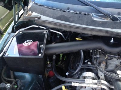

Hey everybody just got my CAI installed and was looking at getting some 1.7 HS roller rockers and was wondering where you got them and if you ran into any trouble on the install.

I'm sure someone will chime in shortly. CAI looks great btw!

nice intake, Iv heard great things about those rockers. you can buy them directly through harland sharp, the guy who runs it, randy jr I think is supposed to be a really great character.

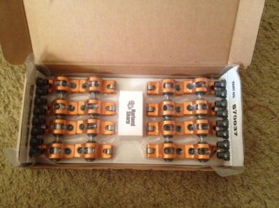

Got home and they were waiting on me

cool. glad you got them. post up when ya get them installed. it will take a few miles before the computer learns them. like a couple hundred or so.
