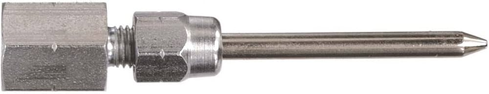

Do you guys use the needle type grease gun tip on the CV joint on your front driveshaft or one like in the attached photo?IMG_2137.png

Isn't the performance injector needle for injecting the rubber boots ?
I would say yes to your question, as he was referencing CV joints in the original post. That video is for exposed U-joints.

neither the grease in your grease gun is the wrong grease cv grease is much thinner. Their is no point using a needle to puncture it and add more grease it is a sealed system unless you had a boot fail.. If you really want to grease it pull the clamps off get a pack of proper grease and add it then put a new clamp on..

It referred to it by the wrong name, it is the double cardan joint on the front driveshaft that I was referring to. It is not a sealed system and there is no boot on it.
