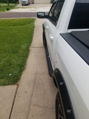

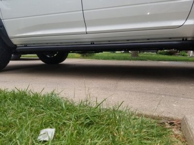

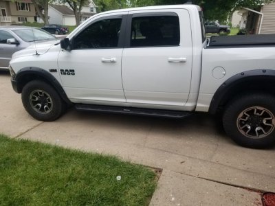

I think I have found the greatest steps ever made!
FYI - I am NOT related to this company or sponsored or compensated in any way for this.
I purchased the GoRhino Dominator D6 steps (D64205T) for my 2017 REBEL and after installing them, I think they are AMAZING. They sit very high and tight. I lost ZERO clearance as the steps are still higher than my skid plates. You almost can't even see them from the side. The brackets are very strong and about 1/4 inch thick. I got them from JEGS and got a $50 off rebate, so they cost about $350 after said and done.
https://www.jegs.com/i/Go-Rhino/239/D64205T/10002/-1

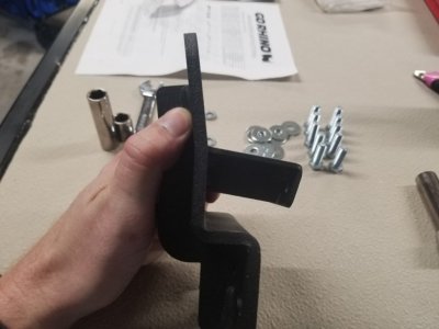

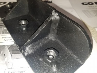

There are three brackets on each side (very beefy center bracket). They did take a while to install, but well worth 2.5 hours. I am 240 lbs and I can jump on them without any flex. Not sure how much protection they would give versus rock slider, but they will at a minimum save my rocker panels from more rock chips. They are beefy enough (I think) to take some hits ON rocks, and still protect the cab.
All factory locations used, no drilling. The only PIA was cleaning out the pain from the factory screw holes.
You can't tell from the pics, but the steps stick out no further than my Mopar flares.

Looks like they bolt into the pinch weld of the cab? The only thing I don't like about that is that eventually the bolts will rust and the paint is compromised from the washers digging into it. Eventually that's where the cab will be prone to start rusting. When I had that style on my truck, I upgraded all the hardware to stainless and I placed plastic washers between the steel washers and the paint. I removed them about a year later and the paint under them was still good as new. Just a thought. Steps look pretty solid tho.

I was thinking the same thing. The blots that came with it for the pinch weld are black oxide, but I will likely be swapping to stainless also. I like the idea of plastic washers. They do mount to the pinch welds and the body holes like the OEM steps do.

They look great! I thought they were more expensive, was looking at the tyger steps they were around 400$ , but will have to look at rhino’s as I also like the high & tight fitment & don’t want them to stick out to far.

I was looking at the Tyger steps also. When I saw how high these sat, I was sold. Some places wanted over $500 for these. JEGS had the best price, plus a coupon code right now. Then on the GoRhino site, you put in for the rebate. The steps shipped from GoRhino directly. I ordered may 23rd, and got them yesterday, but I go the rebate (digital MasterCard) a week ago.

It's a shame nowadays how you have to add a disclaimer just because you're recommending a product. Those are nice steps. I like them better than the Enfab one's which were originally my favorite.
