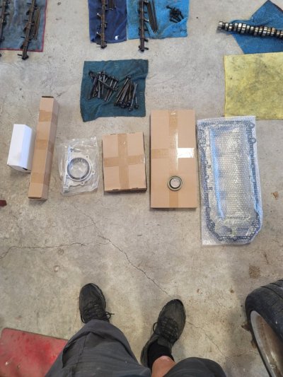

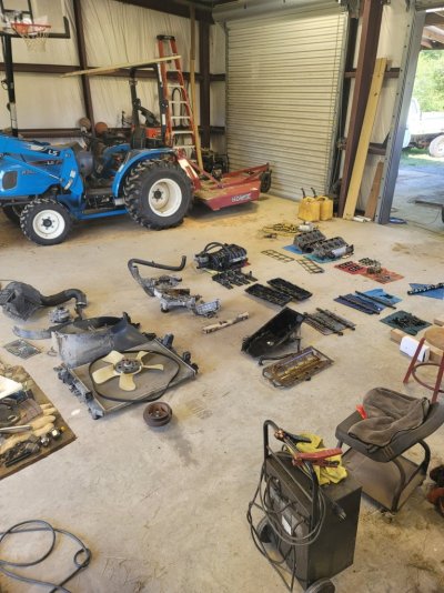

I tore the engine down and laid all parts out in sequence to be sure all went back as it came off.

The kit came with full gasket set and new bolts. Only 2 gaskets were wrong and it was the 2 oil passage gaskets on the intake manifold as the ones supplied were significantly larger than the factory ones.

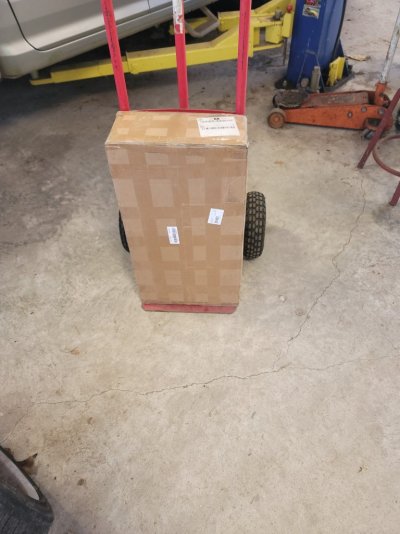

The box as received from LAbWorks

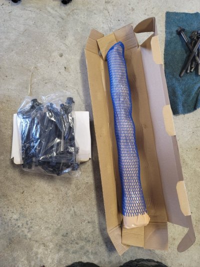

box contents

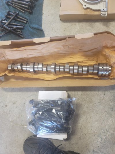

Good Looking Cam. Not a single mark to identify it.
