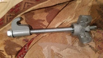

Ended up bringing home a set of spring compressors from harbor freight model #61654.
My plan was to use them when install my 2.5" lift but after seeing some reviews I'm questioning it. Has anyone used these spring compressors?
Or should I just pony up the $55 to but a pair from autozone? Renting in not an option bevause closesr autozone is 35 miles away and I need them for longer than 48 hrs

Try them.
A lot of reviews I've found on HF are older, and they have since improved a lot of stuff.

After reading and searching more I found that the max coil thickness is 5/8" and the max coil diameter is 6".. I don't know about this :crazy:

I've used them on several cars. They'll fight a little bit by twisting, but they work pretty well.

I've stripped one of those out before and it never flew apart. I say try it but use something to tether it so it doesn't get you if it comes apart.

Yep, just get a ubolt with the washer that goes across both legs to lock it on the coil and you'll be fine.
Are the springs in the cars anywhere close to size in your 1500's?
What vehicle springs did you use it on?
I plan on taking the track bar and sway bar off and then I only need to compress the new stock spring to get a 2.5" spacer in with the axle dropped as much as possible. So I doubt ill be compressing the spring much? I hope :) lol
If the compressor breaks in 2 pieces (threaded bolt breaks) won't it render the washer and ubolt useless and go shooting across the room?

To be completely honest I was young and dumb this must of been 8-9 years ago a buddy and I were trying to get the spring out if his el camino I don't even remember why now but there may or may not of been a impact used in the process :roflsquared: (and I have now learned how to properly remove coil springs) my point is that we made the compressor fail and it still didn't come apart. On a coil over there isn't near the stress that there is on the standered coil spring it shouldnt be to much of a issue does it have to of the compressors or just 1 it needs to be evenly compressed on both sides.

I'm gonna use the autozone ones and the HF so 4 at a time on the coil just in case one fails lol :)
