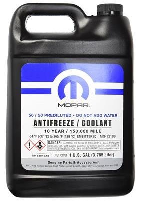

Going 150,000 miles on OAT is silly IMO.
Why risk it?

Risk what? That's what the Mopar OAT coolant is rated for. Look at the Cummins coolant, it's a million mile coolant provided you regularly check it.
People think an engine will grenade if you go over 3K on an oil change, anything less than 7500 miles on a full synthetic and your wasting money. You do realize that CTD OCI is 15K miles?

Anything less than 5k is waste of money on dino oil also, 3k oil change myth is to keep quick lube places in business.
