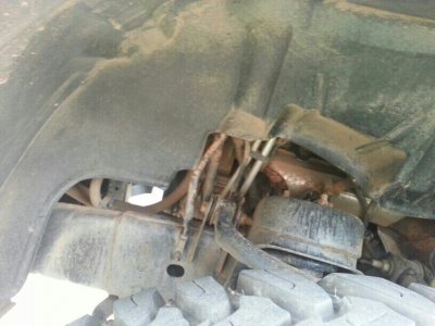

Before and after. Gap guards are a must on the newer Rams. Rear does not need any.
