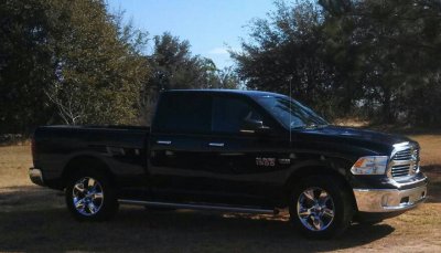

I just got the level kit on it DID push my ball joints up a little but not too bad hopefully they'll stay in place at the tire shop now getting tires installed this is a before pic

Do you mean yours pushed the ball joints out of your control arms or just moved the ball joint higher?
No it didn't push them out of the control arm it just moved one side up higher because of the angle. The side closest to the motor is still seated right but the side closest to my tire has raised up about 1/16th on driver and passenger side.

That sucks, I wonder if any with Bilsteins has had the ball joint issue?
I would think that if you put the bilsteins at 2.5 like the spacer it would do the ball joint the same it looks like its the angle that makes the ball joint come up
