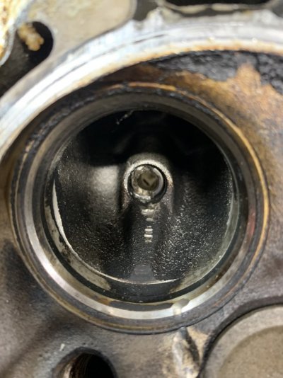

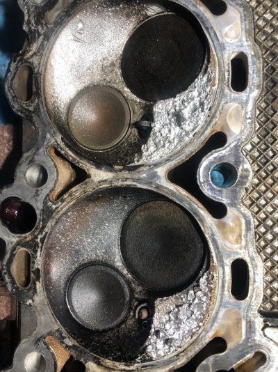

If its just that one spot and the chip on the valve seat then yes. But what will that cost as opposed to a brand new head?
This was mine.

Looks like you need new valve guide, valve seat, valve, valve job. Got lucky that valve didn’t break and do the same as Ole bucks. Call a machine shop and see what they quote vs buying a new head.
Side story I had a valve drop in a Briggs lawnmower engine I had built for racing. That was fun. Took out the piston and the cylinder wall too… looked just like Ole bucks picture except with gouges down the cylinder wall from when the valve seat dropping out.

Machine shop said probably a couple hundred bucks per head to freshen up, obviously plus parts. Only place I found reman. Heads were rock auto and they were about 700-800 each. If you guys have any good decent priced places for remanufactured heads I’m all ears.

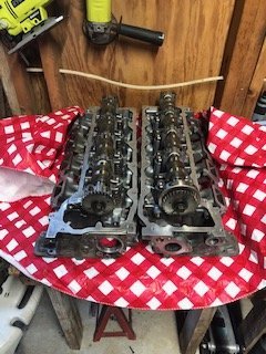

I found a company that sells complete remanufactured heads for $425 each. What are your guys thoughts on if I should just replace the bad or both if I end up not being able to get one head repaired. Debating both new heads for the simple fact of how “fun” it is getting these motors apart haha
Ole Buck
Aug 20, 2021
331
289
South Alabama
4.7
just my two cents unless its a strict budget, meaning one head and eating for a week i would do both. Put a new on one side and its back to factory specs while the other side has humpteen miles on it and something is going to give. That's just my opinion. Are the new heads complete meaning ready to bolt on or will they still need cams lifters springs and stuff installed?

4.7 ho
Complete heads with valve train and cams. Probably have to use my own timing gears and Egr is my guess. Seems like a pretty good deal I’m thinking.
