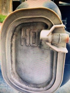

My cams came from a 2004 Jeep Grand Cherokee HO. It was the last year that these particular cams were made. From what I understand my intake was a one year only that came from a 2002 Grand Cherokee HO 4.7

TaxRam
Jun 26, 2021
Chicago
2006
I'm not sure what trucks came with the 4.7 H.O, but they were in available in the 2002-2004 Jeep Grand Cherokee in the Overland, Limited, and Freedom trims. Overlands and Freedoms are hard-ish to find but Limiteds are somewhat common. They came with a badge on them that said "4.7L H.O." on the rear hatch. If you have a LKQ pick your part or a pick-n-pull near you, check their inventory on their website.
