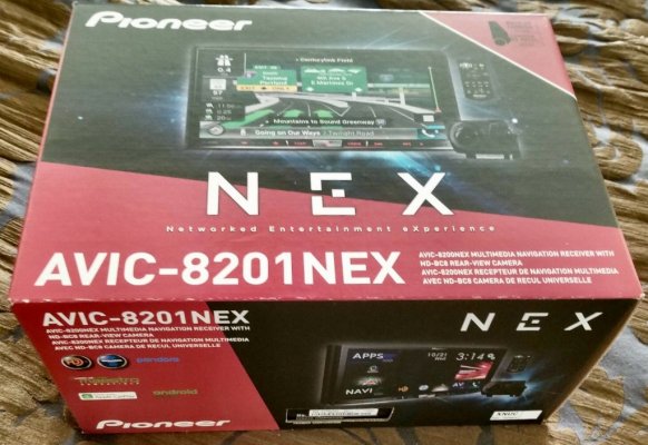

I always suggest to those like myself with an older truck 2009-2012 to upgrade their headunit with an aftermarket one. Those radios were fine when they first came out, but with technology as it is, there’s no reason to stay behind. You don’t need to buy the fanciest one that they make, just get what you need, and enjoy. This is what I have which is wayyyyyyyyy overkill, but keeps me occupied lol.b4e6b47f16b88f3a9a4149815bfab1d7.jpg

Crutchfield is great for feature comparisons. I went Kenwood and it is awesome what all it does.

Do you use the Bluetooth for making calls? How does it work? The last couple times I've put in aftermarket head units (07 Edge, 08 Mazda 3) the BT for maiing calls was terrible. People couldn't hear me well. Does the OEM mic hook into it? Honestly, that's one of the things I like most about my OEM unit, the phone feature works great. I also like that the NAV puts the directions in the center console, but that's not an necessity.

Speaking for myself Bluetooth is a dream and unless I’m calling with my windows down, sound is same as oem. The main difference is that you can see my mic as I didn’t feel the need to integrate it into the headliner.
