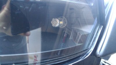

I used led for the turn signals. You will need to add the resistors, it is a simple process. These led's and resistors can be picked up at places like Autozone fairly cheap. For your other lights I would suggest not going the cheap route and many will recommend opt7 fluxbeam x. That is the route I will probably take with these new lights.
