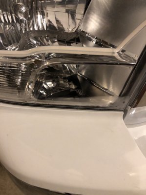

I have a 2011 ram 1500 Laramie. I bought a used set of 2015 quad headlights. Opened them up and installed the diode dynamics halos as well as some 3157 switchback bulbs for the corner lights. I also bought led headlight bulbs for my low beams. I sealed the headlights with morimoto butyl after removing the permaseal. Took my time and thought I sealed everything up properly. Well after using them for two days, it was raining a lot, and I started noticing the lights fogging up towards the bottom. I got a sinking feeling in my stomach so I pulled them out, brought them inside and put a hair dryer to them. I then decided to go ahead and seal the lights with silicon around the outside for extra security as well as I had some extra silica gel packs that I added. Put them back in the truck and the last couple days we’ve had nice weather but I’ve noticed that I will run the halos and the bulbs and after I get out and let the vehicle sit, it will fog up again towards the bottom on both headlights. If I let it sit over night though, it will be cleared by the next morning. It’s driving me nuts as I’ve spent a lot of time and money on this project. Any advice anyone can give me would be greatly appreciated! Sorry for the long post!

Well I pulled both headlights back out tonight. I decided to try something else while checking the vent caps. I got my wife’s hair dryer and I mixed a bottle of soapy water. I left all the caps on except the side marker. Turned the hairdryer on and sprayed soapy water around the lenses where it joined the housings and also sprayed the dust cap which I cut a hole in to run the wire. On the dust cap, I used some butyl on the outside of the hole I cut out. Come to find out both of the holes I cut out were leaking around the wires and I also found 1 really small spot on each headlight where the housings joined the lenses. Got my silicone back out and put a generous helping along the spots I found. As far as the hole for the wire, I decided to put butyl on the inside and outside of the wire and smushed the butyl in the hole and around the wires. I also added some silicone to the outside of the dust cap as well on top of the butyl. I know it sounds Jerry rigged but no one should ever see it. All 4 vent caps were also pushed all the way in. I adjusted them to where they are barely on. I had contemplated just taking the caps off completely since they had the gortex film over the hole anyway. I am letting my lights cure a little bit tonight before putting them back on early in the morning. I’ve included a few pictures of what my lenses looked like from the condensation. It wasn’t a lot, but it was enough to bother my ocd!

Well I’m reporting back and after all the resealing. I’m still getting so fogging towards the bottom! It seems to happen after I run the halos. I’m at a loss now!
