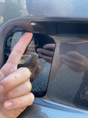

i turned the adjustment screw this morning and the bottom gap closed a lot. I’m still going to see if I can mount them in the stock bracket so they’ll line up better. I’ll let you know. It’ll be a few days before I can get to it though I’m sure. Work is a bit crazy right now with the protests and all.
They wont work with the stock brackets. I got mine yesterday and got them installed, only to find out how garbage the brackets they come with are. Also, the spring on the adjustment screw is not strong enough. I transferred my stock spring and it helped to keep the lights stationary. Where the bracket goes over the post on the lights, mine kept popping off and the lights moved around a bunch and would not raise/lower. I ended up taking them back out and running a short screw in with a large washer to keep the bracket from popping off. Got them reinstalled and they're solid now. I'll try to remember to get a picture later to clarify if it doesnt make sense.

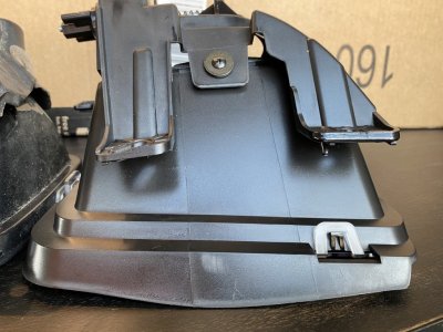

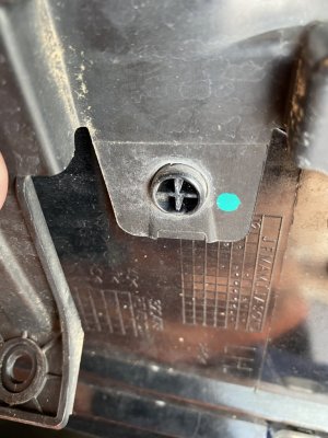

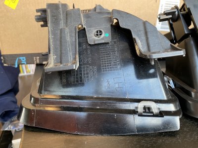

yea if you could send some photos so I can see what you mean. I was able to get one stock bracket on the new light and it brought the light closer to the bumper to make it more flush. I’ll need to sand down the side holes so the screw and washer can fit right. If it doesn’t and I can’t use the stock bracket again, oh well. I’ll send these back and buy morimotos. Here are some pictures to compare the stock bracket and the aftermarket one. You can tell the stock one makes the light stick out further which makes it more flush with the bumper. I’m doing this on my phone so the photos may come out in the wrong order. I’ll try later to make it a better post for you guys.
Stock on left, aftermarket on right
Aftermarket. Gap between the top right (looking at this photo) bracket hole and fog light front is small. Makes lights further from bumper cutouts.
Stock. Gap between the top right (looking at photo) bracket hole and fog light front is larger. Brings lights closer to bumper cutout.
Stock Bracket and light
Stock Bracket on Aftermarket light. I'll need to sand the stock hole just a little.
I'm assuming the one on the left is stock, and the one on the right is the z-offroad light? Did yours come with that screw and washer on it where the bracket goes over the post on the light? That is what I had to add. Mine did not have that, just the post with a hole in the middle, and the bracket kept popping off. I dug around in my "misc junk screw/bolt" bin and found 4 screws and washers to fit to keep the bracket on.
When I tried to install my OEM bracket onto the z-offroad lights, the hole in the OEM bracket was too large for the post on the lights. It looks like yours is opposite and the OEM bracket is too small? That's odd. The box on mine said something to the effect of "new style bracket", or something along those lines. I'll check when I get home.
Yea I just jumped on the computer to make some adjustments to the post. Left is stock and right is Z-Offroad. Mine came just as it is pictured with the screw, washer, and a rubber washer under the metal one. When I was ordering these I saw a review and he said the customer service told him to get when mine came with and it fixed his issue. Kinda like what you had to do.
Mine does appear to be the exact opposite from the issue you're having with them. My stock bracket has a smaller hole than the post on the aftermarket light. I'll sand it down just a hair for a snug fit and I think it'll work just fine. I have a feeling mine is the newer style since customer service told that guy to buy the parts that mine came with. I'll check the box tonight and see what the top label says.

I was able to dremel out the holes and they fit right into the stock brackets. Mounted in and almost flush with the bumper cutouts. Lights are nice and snug. I like the look of them (in the dark). The light output is brighter than my crappy Spyder headlights. I have a few pictures of the light. If anyone needs anymore information just ask away. I took a picture with the fogs off and then on so you can see the light output in the parking lot.

Here are some daytime photos of the new fogs on the stock brackets. As you can tell, it brought them a lot closer to the bumper and closed the gap. I also added some smoked LED tag lights this afternoon.
if that’s your fog lights, they are aimed way too high.
that was with the aftermarket brackets on. I haven’t been able to get a photo with them mounted in the stock brackets. Heck I haven’t even cut them on at night yet to be honest.

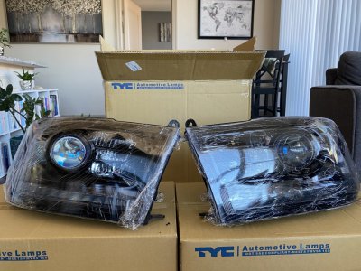

Got my TYCs in today. Excited as hell to have a few hours one day soon to hook them up. Gotta research all these wires it came with though. Not familiar at all with the HID stuff. Picture isn’t the best I know.
NJMOPAR
Older and faster
Jan 23, 2020
2,642
7,322
ELizabeth, NJ
HIDs require ballasts & decoders (unless you use AlfaOBD). The wire on the bulb faces down.
35w ballasts produce true bulb color, 55w is brighter & farther but drops the color rating a bit.
A 35w 5000k will be true white, but a 55w 6000k will be just as white being @ 5500k with the higher ballast.

Yea it came with all the wiring I need. But, it’s more than I expected. I’m hoping it’ll match the LED fogs since I ordered them separately. It’s a 35w ballasts with 5000k kit.
If you got HID to go with them, I highly recommend downloading AlfaOBD and getting a Bluetooth dongle and just changing the settings instead of installing that mess of a wiring harness. I had the harness and was having issues randomly (one light wouldn’t fire all the time). I yanked it, got the app and changed the settings. No more mess of wires, no issues.
I’ll have to look into that. So when you get that, you don’t need all the extra wires? Seems a lot easier.
The only wiring needed outside of OEM is the adapter harness for the projectors, if you’re coming from quads. And of course the ballast to bulb wires that need to go through the dust cap on the porjector housing. It eliminates the massive HID relay harness, that is a common failure point.
