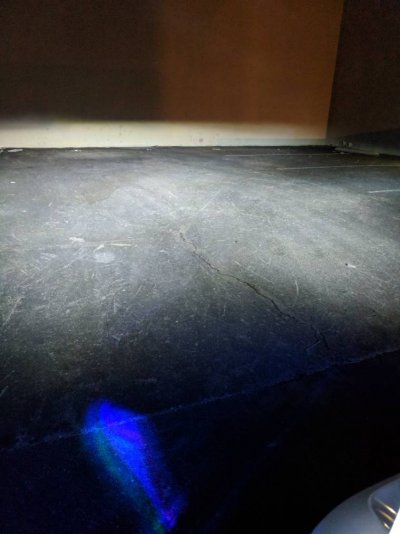

If you have the time and patience I would put projectors and HIDs in them. LEDs do put more output but in our headlights. Top pic of LED low beam output in stock headlights. Bottom is LED in retrofit projectors.dea87f64016491ec201688e372abcabb.jpg3b16c21fc053b5187606398675c4cbf9.jpg

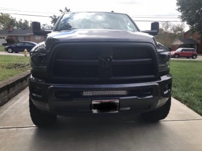

DA5F3B39-431A-4D3F-8EEE-7A02767DD72A.jpeg I just did the Opt 7 LED upgrades in my 2018 quad housing. They send you all the possible adapters with the lights for $89 with coupon. I had to lower them to get the top of the beam where it was before.

View attachment 145042 I just did the Opt 7 LED upgrades in my 2018 quad housing. They send you all the possible adapters with the lights for $89 with coupon. I had to lower them to get the top of the beam where it was before.
How much difference vs stock?
Sent from my Pixel using Tapatalk
How much time & patience needed?

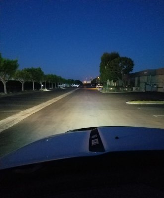

I have Vanquish auto(vendor here) led low beams and fogs in my 17. World of difference in being able to see.Screenshot_20181029-204940_Photos.jpg
Fit great and no antiflicker module needed on my truck

Have a 17' & headlights are horrible. I assume I have the quad housing ones then??
L
Huge difference as you can see from the picture I loaded with one installed. I had to aim them down a bit from the factory adjustment or I’d be blinding everyone. I didn’t need the included capacitors or the resisters, just the wiring adapter.
