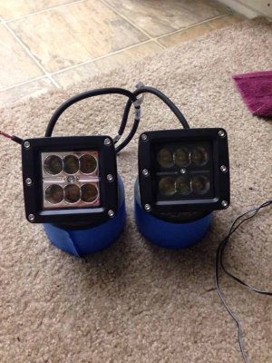

What led pod is that?
It's just a spare one I had In my tool box. I'm going to be getting two brand new ones. My buddy owns his own lighting company so they are just generic china but I get them for $40 each

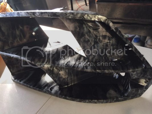

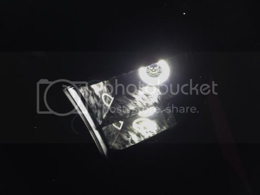

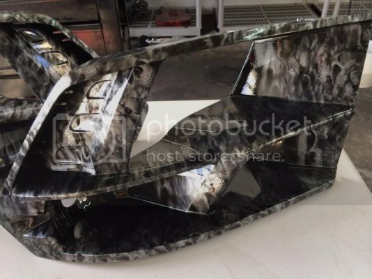

Alright guys. Here's an update. ImageUploadedByTapatalk1407314294.282441.jpgImageUploadedByTapatalk1407314302.080522.jpg
I am blacking everything out and not taking any stops. I have a 6 led pod which will be wired directly to my trucks high beam control I have blue oracle lights and blue LEDs back lighting the pod. I also have led turn signals. I should be finished tomorrow. I will post more pictures as I progress.
