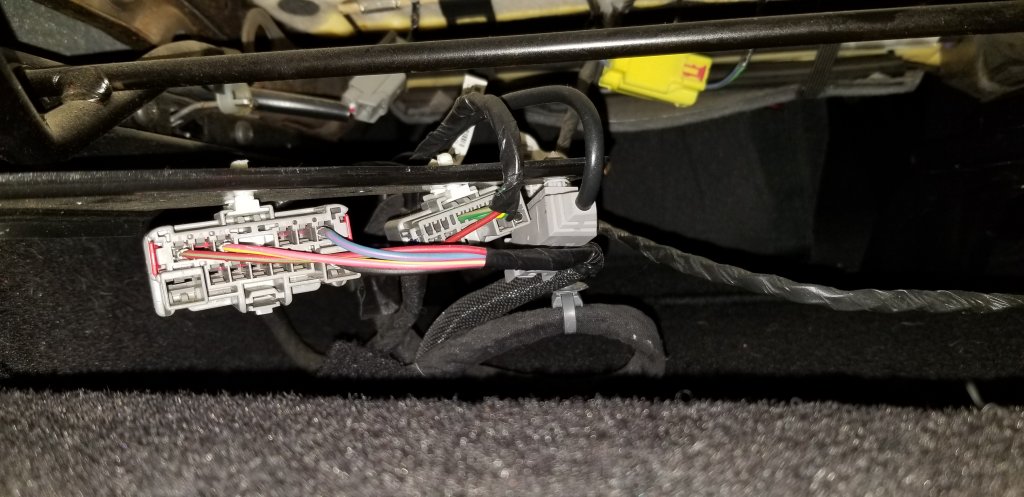

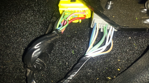

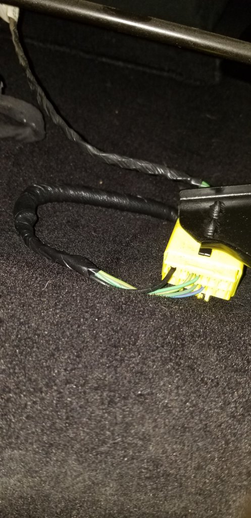

I know this topic has been discussed a ton but I have a question I can't find the answer too. I have a 14 slt quad cab. I dont know if the wiring under the seat is there or not and I want heated seats. The wiring obviously makes a big difference on which way I decide to go. OEM vs. Aftermarket. I have 2 pictures of my under seat plugs and hopefully someone can tell me if I do or dont. The single yellow plug is the left front of the seat if your looking down on the seat from above. The others would be towards the opposite corner.20191224_172340.jpg

Havnt seen a dodge with heated seat connectors unless it was ordered with heated seats. Aftermarket is easier in my opinion because it comes with everything. Factory you'd need the switches and wiring and I Beleive the bcm reflashed/alfaobd to make it work.

Not to contradict you but some comments in the posts about seats said some trucks come rewired and some dont Something like all regular cabs do, some SLT's etc. That's what I'm trying to figure out since there is so much into floating around. I appreciate the comments too.

Easiest way to see is pull the wires down and see where the wire goes in on one side and if it comes out the other side connector. If you have extra wires on the truck side it's likely you have the harness. Some do come with not saying it's not possible but almost every one I've seen doesn't have em. Just a trend I've seen.

Your truck is not pre wired for heated/vented seats and heated wheel. Some SLT's are depending on what options they have but most aren't. As a rule of thumb the Bighorn and higher trim levels will have the wiring even if they didn't come with the heated seats. All regular cabs are pre wired for heated/vented seats. As I'm sure you know you can purchase a pre made harness from M2mods and install the factory setup if you want or you can go aftermarket. The factory system is integrated into your truck and obviously looks factory and you can add the heated wheel which is nice but the aftermarket setup is much cheaper and should also work well. It's all a matter of preference. This is a picture of what the drivers seat connector looks like when the truck is pre wired for the heated/vented seats and heated wheel. 0b48c780f440229695c7ed9ed066e0e9.jpg
